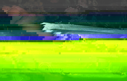

Can anyone tell me what this port on the back of the head is for? I have seen it on all images of the heads, but nothing ever connected to it. Is this some sort of service port to clean the inside out or something? I do have a gasket for it in my full engine gasket set.
