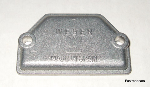

I checked see to have two sort of weber with and without now i was doubt about it and someone confirm me it the same carb. You can buy the cold start separate and install in on the existing weber ! Brupp am rookie in weber to so i don't know
Blanking plate
Cold start elimination kit
Blanking plate

Oh interesting.. The top image looks like mine, I didn't realize the mechanism was so simple! Yeah, then it looks like you could have it either way, and converting to or from wouldn't be very hard at all.

Picture was is from ebay an guy selling this set togetherSpudenater wrote:Oh interesting.. The top image looks like mine, I didn't realize the mechanism was so simple! Yeah, then it looks like you could have it either way, and converting to or from wouldn't be very hard at all.
