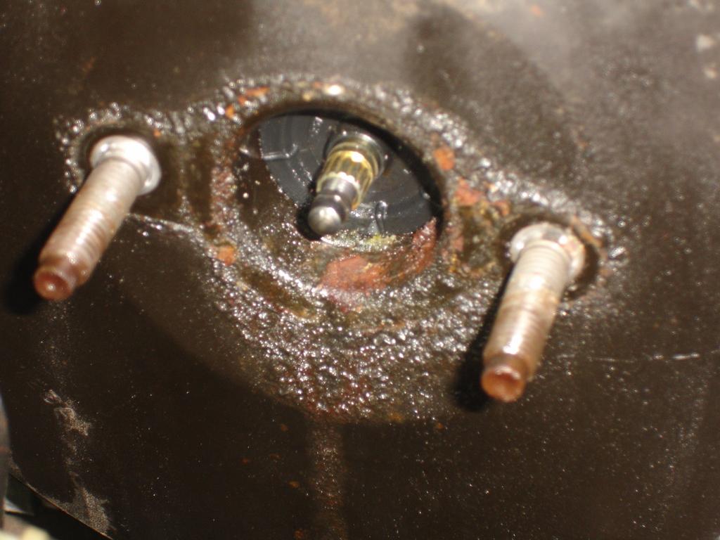

Re: Brake fluid engine smoke?
Correct
If the booster is leaking inside the car then the rubber already corroded by the brake fluid !
If you master don't leak no need to changing it
Here is the samble when master is leaking
