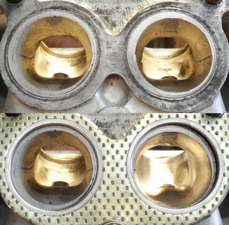

Here is an exhaust port view at Mazda/Probe 2.2 liter head the right side goes from undone to nearly finished... left side is the control so you can see the actual port work
Same Mazda/Probe, this time the intake side... the control is the stamped #8 at the top of each
I hope this provides some ideas.......
