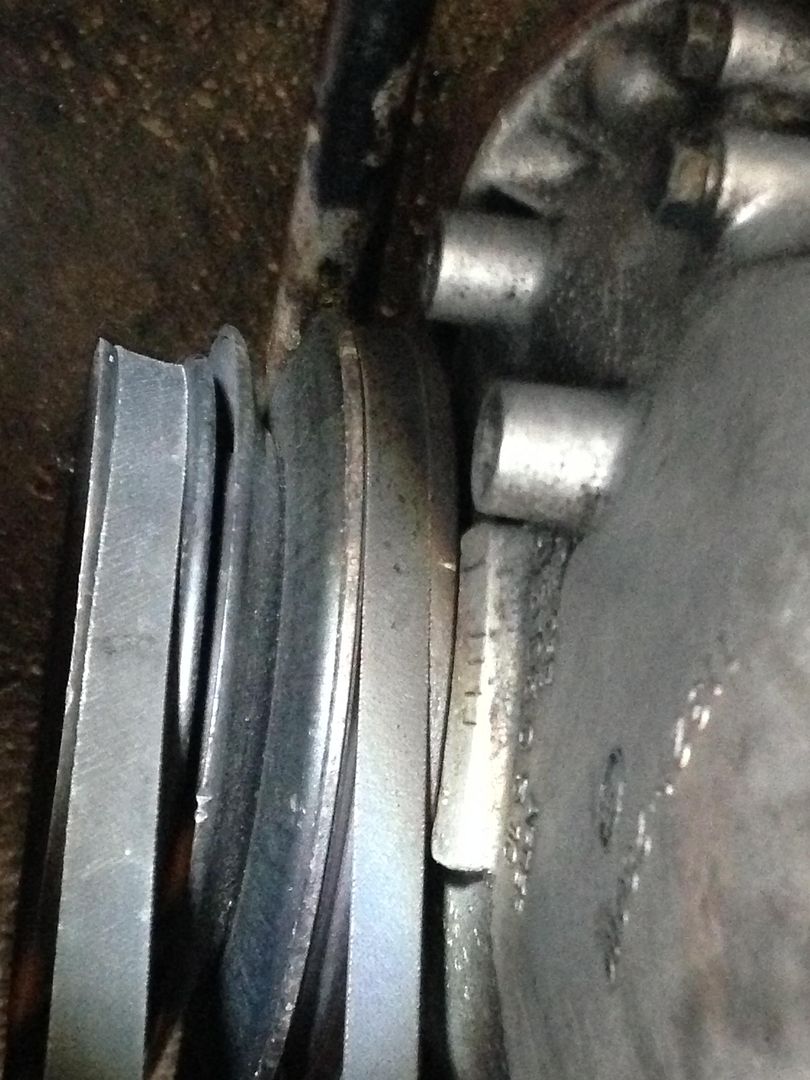

Just a quick tuning question. With the old setup, my timing was -20 at idle, like you see in the picture.
Since I'm automatic and don't race or anything, I'd want more low and mid rpm power than higher rpm range. Should I set the timing different or leave it as is?
