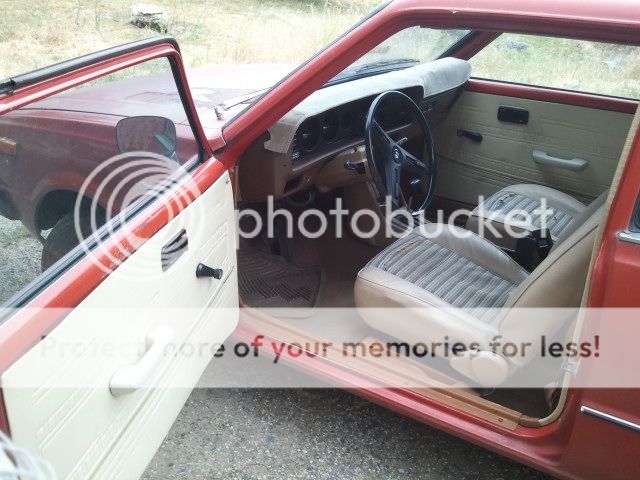

I purchased this TE31 about a year ago. It is a 1976 deluxe edition which has a 2tc with a 3 speed auto in it. It has 38k (non rolled over?) miles. Here it is after making the 230 mile trip home with no mojor problems.

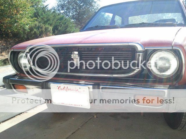

Decided to freshen up the grill:
