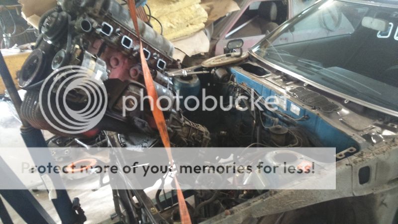

Post by Heiska » Sun Jul 21, 2013 9:55 am
W55 gearbox arrived.

Post by AE25 » Mon Jul 22, 2013 9:45 am
good to see progress on the rust. never ending on these coupes!
A gearbox crossmember to suit the W box into E7 is from the A6 series celica/carina. the auto crossmember almost bolts in. need only about 3mm slotting of the holes. but box will have slight offset to one side. It hasn't affected my conversion though. The manual crossmember from a *A63 with w55 box requires more slotting of holes than the auto.
hope you know the bell housing is from a toyota 1G- 2ltr 6cylinder. Should have a "G" cast in the end face. same bolt pattern but clutch fork/slave is on exhaust side. genuine 3tgte bell has it on intake side.
can use the flywheel from the 1g-eu/1gge/1ggte which uses a larger 225mm clutch, clutch is interchangeable with 18r hilux. it's what the 3tgte has, same flywheel as a 1g-eu. 8kg weight. but definately buy a heavy duty pressure plate because std 1g-eu/18r clutch is too soft.
hope that helps
Post by Heiska » Tue Jul 23, 2013 4:35 pm
AE25 wrote:good to see progress on the rust. never ending on these coupes!
hope that helps
Thanks for the info.
Yes, that is G bellhousing but should be fittable on T series engine.
About that crossmember, it would be hard to find one in here. Ma61 is the only one with w55--> gearbox in here, what i know. A6 carina is with T or W51. So i think im going to make it myself. And automat a6 is even harder to find.
That 1g flywheel is good info, have to keep that in mind.

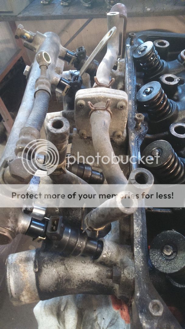

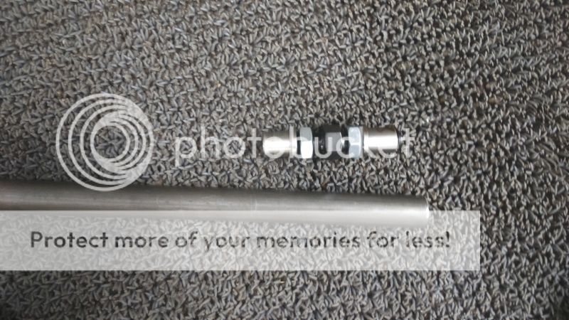

Post by Heiska » Thu Sep 05, 2013 5:45 am
Allmost like intercooler, but smaller :lol:
