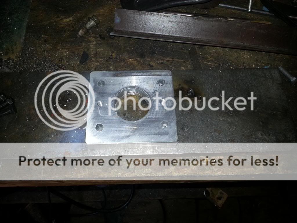

Wilwood master for delete brake booster
I haven don''t this modification my self but the needed are simple the master and an custom aluminum adapter plate with the 4 bolt that attach to the existing booster hole and the pattern for the wilwood.
The rods need to modified a bit but isn't much work

Mazota el pedal se pone como palo,you got,to press hard on it to stop but it does work,,one thing I noticed on my starlet I had 4 wheel disc brake and after I did this mod. The pedal wasn't that hard and the wagon would lock the wheels if I braked hard,,,but now on the .8 I have the same mod. But the rear brakes are drum and I notice it's harder to stop ,,hope this lil info helps
