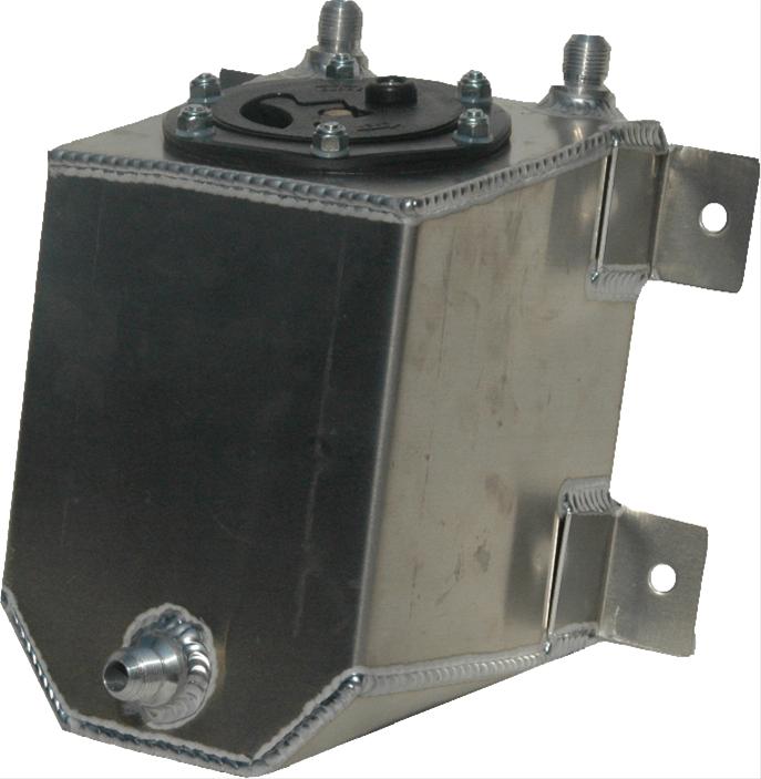

I used this 1 gallon aluminum fuel cell as a surge tank for my TE37:
Then installed a bulkhead fitting for a feed tube to fill the surge tank through a fuel pump, connected the bottom bung to a fuel pump going to the fuel rail, return line going back to the surge tank and a return line going to the main tank.

I ended up soldering aluminum tubes replacing the original ones. You don't really need to do it the way I did mine. Since you have the lines up and running already, just use those to connect to the surge tank, what matters is you are able to fill up the surge tank and circulate the excess fuel. You can use Volvo fuel pumps that are readily available in many Pick your Part yards, make sure to use filters on both sides. I hope that makes sense.

Interesting I also ran a surge tank when I injected my TA27 but have had several issues that I hope to have finally worked out but I used the same set up basically but the fuel returning from the rail would heat up the surge tank and the hot fuel would end up killing the efi pump because of the hot fuel. very frustrating. Good Luck stay safe

That might have had the desired effect I just rerouted the return line to the tank, overflow to the tank from the surge tank and capped one of the ports on the surge tank. I also increased the feed to to the lift pump and from the lift pump to the surge tank with -8an lines the lift pump being a carter electric 4600hp this seems to have solved those issues. Stay safe

I have to agree with that I welded a small sump with a 3/8 NPT female fitting and then used -8AN to feed the surge tank, The drain plug I kept for just that, a drain plug.
