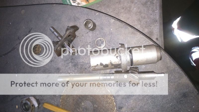

Going to paint it when the rack and pinion is on place.
Toyota didnt sell me orginal 3tgteu one so have to make it from and old 2t dizzy.

Postby Heiska » Fri Nov 06, 2015 6:25 pm
Got my "dizzy" back.
Postby BOBLOOK » Tue Nov 10, 2015 10:27 am
waste spark ?
Posts: 2263
Postby Heiska » Tue Nov 10, 2015 9:37 pm
BOBLOOK wrote:waste spark ?
Yep.

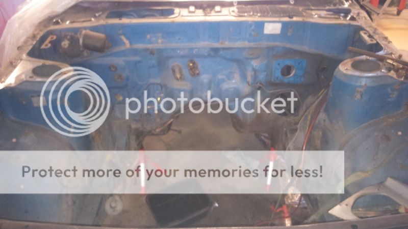

Postby Heiska » Mon Apr 04, 2016 4:20 pm
Has been while :D
Just boughted nissan 200 sx front end, few pics of them compared to te71
te71 bush is 12mm hole and nissan is 14mm
Controll arm bolts are: te71 10mm, nissan 12mm
+bigger brakes
+better bearing
+No ae86 prices :D
+same bolt pattern
Nissan crossmember is also quite similar only 0,5cm differense on the bolt holes.
